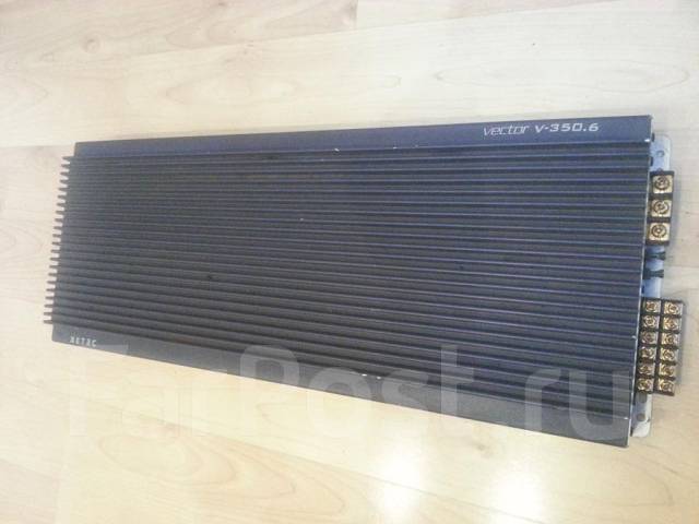

Tambien tengo una Xetec Vector 350.6 que no se si usare debido a su tamaño, si bien da mas calidad que la magnat
1378819628821_bulletin
RMS Output power @ 4 Ohms: 4x50 W + 2x 75 W
RMS Output power @ 2Ohms: 4x63 W + 2x 90 W
RMS Output power @ 4 Ohms: 2x125 W + 1x 180 W in bridged mode
Subwoofer output power @ 4 Ohms: 1x180 W
Subwoofer output power @ 2 Ohms: 1x250 W
Peak output power: 500 W total
Max input Current (@ 13,8 V): 85 A
Idle current (no signal): 1,4 A
Max Current (@ 13,8 V): 100 A
Fuse: 2x40 A
Total Harmonic Distortion (THD): <0,10 %
SNR: >90 dB(A)
Freq. Response (bypass mode): 20 Hz-40.000 Hz (in bypass mode)
Damping Factor; >200 (50 Hz)
Stability: >2 Ohm, (>4 Ohm in bridged mode!)
Input Sensitivity: 250 mV-4 V
Crossover frequencies: 32 HZ-320 Hz highpass,
Crossover frequencies Subwoofer : 50-200Hz lowpass
