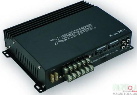

AUDIOSYSTEM X-ION 70.4
X-ION 70.4
Stereo Power RMS @ 4 Ohm4 x 70WStereo Power RMS @ 2 Ohm4 x 90WBridge Power RMS @ 4 Ohm2 x 180WDimensions234mm x 180mm x 58mm

AMPLIFICADORES QUE ENTRAN DEBAJO DEL TAPIZADO DEL MALETERO
X-ION 70.4
FLI AUDIO
FL900
4 ohm stereo : 4 x 100 watts RMS
2 ohm stereo : 4 x 115 watts RMS
4 ohm mono : 2 x 225 watts RMS
2 ohm mono : N/A
Max power : 900 watts
Frequency response : 20Hz – 20KHz
THD : 0.2%
Bass boost : 0 – 12dB
Crossover Freq : 50 – 500 Hz
Subsonic filter : N/A
Remote control : Optional
Height : 55mm
Width : 237mm
Depth : 203mm
