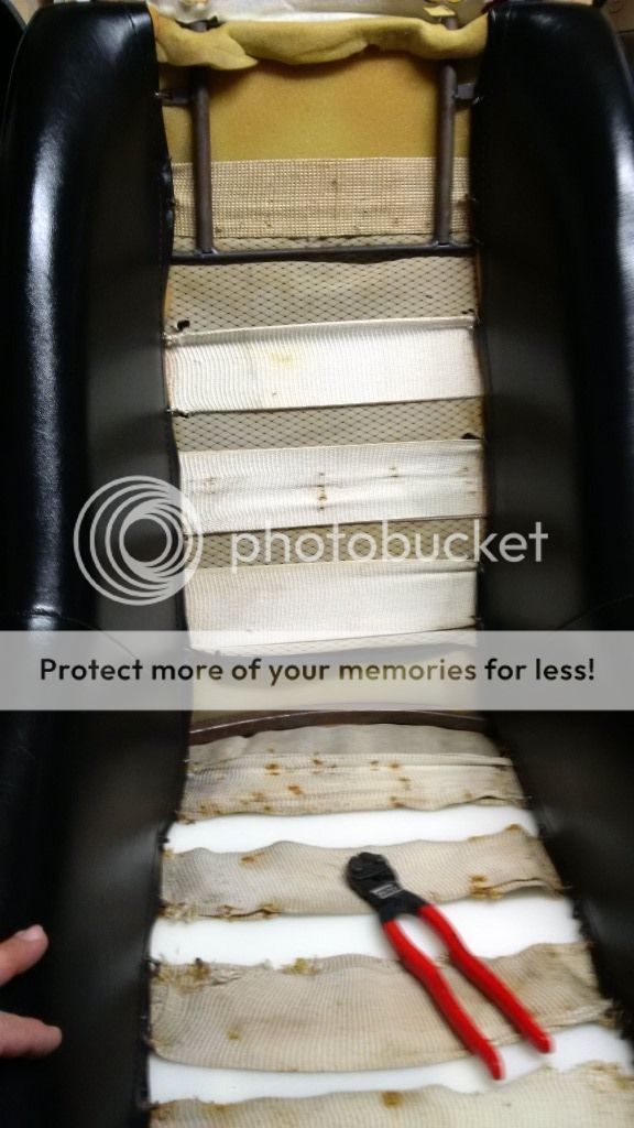

y ya hemos empezado a romper,
upholstery,
start disassemble:
must remove odd clamps
look how peculiar are the sections of cloth fixed to the elastic straps, using the same type of clamps every time
the two laterals of the seat are fixed front to rear using two Steel wires fixed together by the clamps
must renew the straps using new ones
i will treat the frame against rust, using a curative procedure, and probably repaint in black afterwards
see how the two wires i mentioned are tightened along the seam lines

mas tripas,...
while waiting for help i continue dissasembling the seat:
inner frame:
lower frame rusty
treated with pasivator:
painted
foams and cloth:
