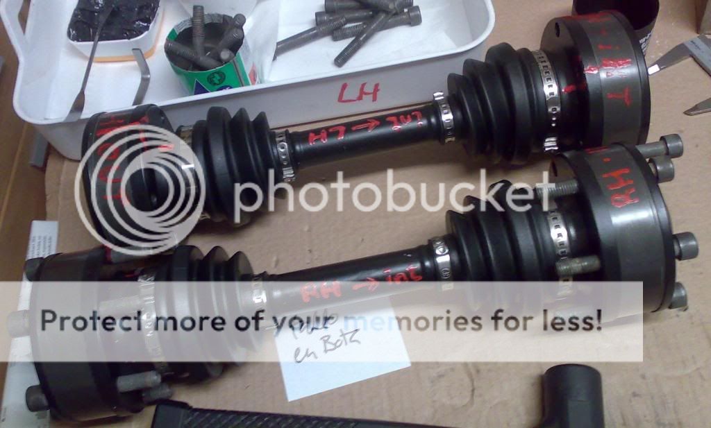

tenia un fuelle roto...asi que no me he podido resistir
lo siento, esta en ingles, me da pereza traducirlo de nuevo

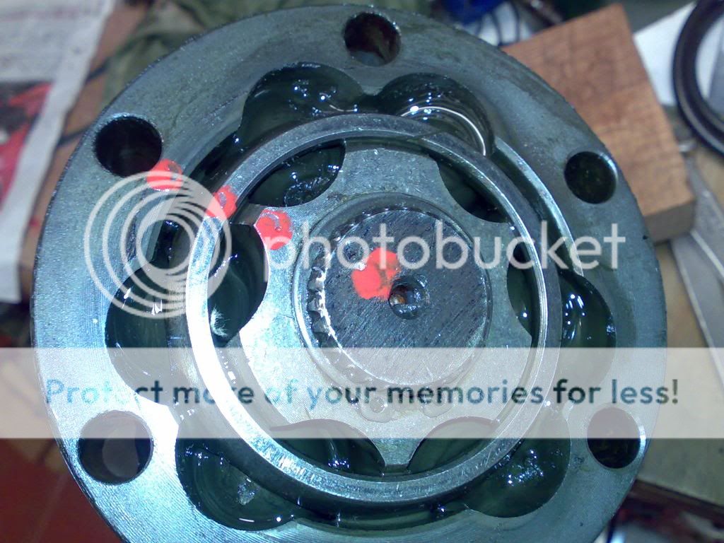

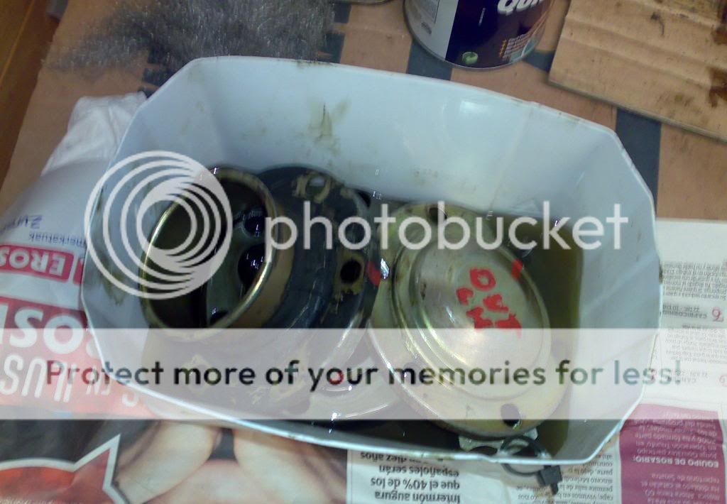

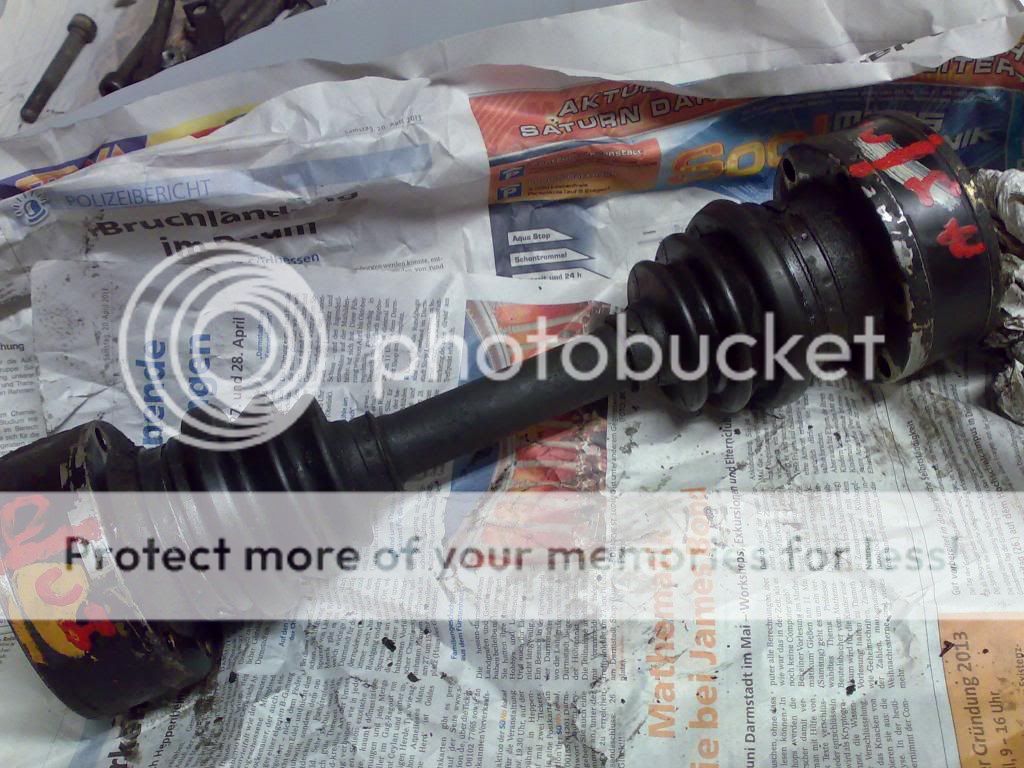

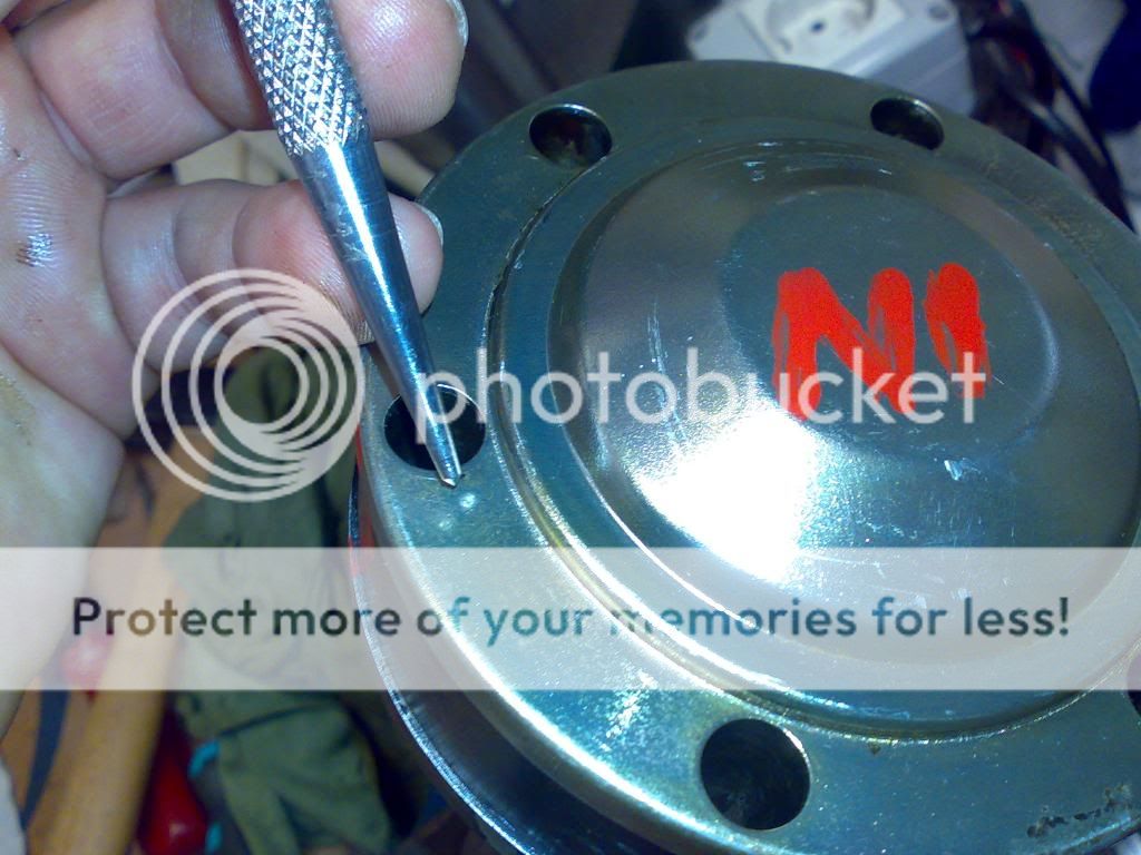

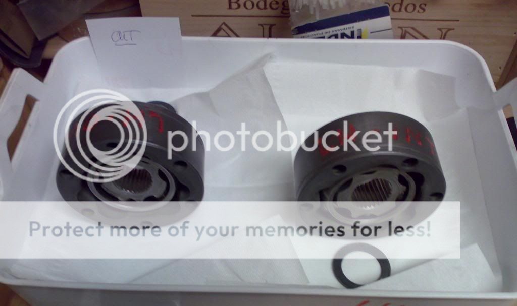

first thing after cleaning and before reomving them, is to mark them as clear as possible, i marked the relative position of all elements, probably is not needed, but...

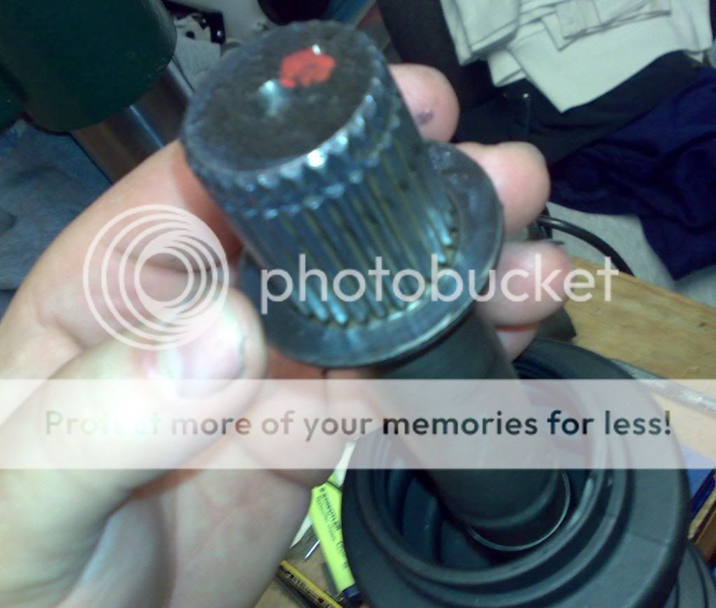

just a curiousity, the shafts were painted to identify side:
yellow paint means outer (wheel side)
white paint mark means inner (differential side)

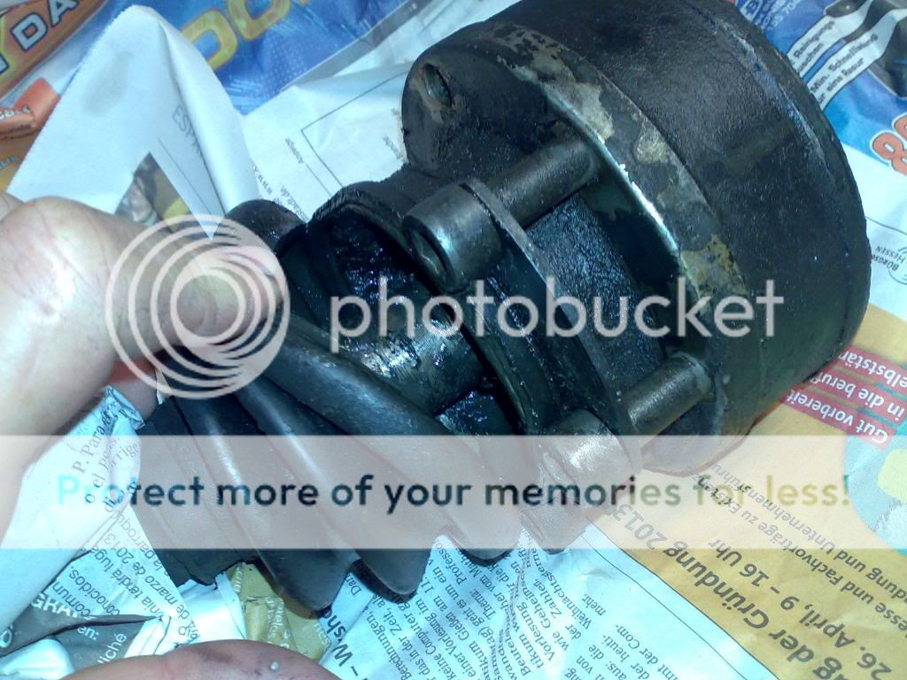

here a detailed view of the broken rubber boot that caused this nasty work:
la cosa mas guarra que he hecho nunca:

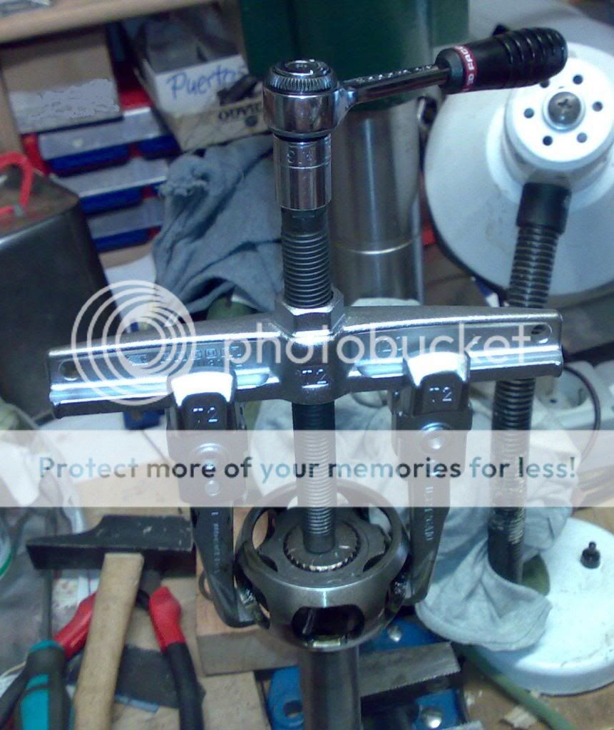

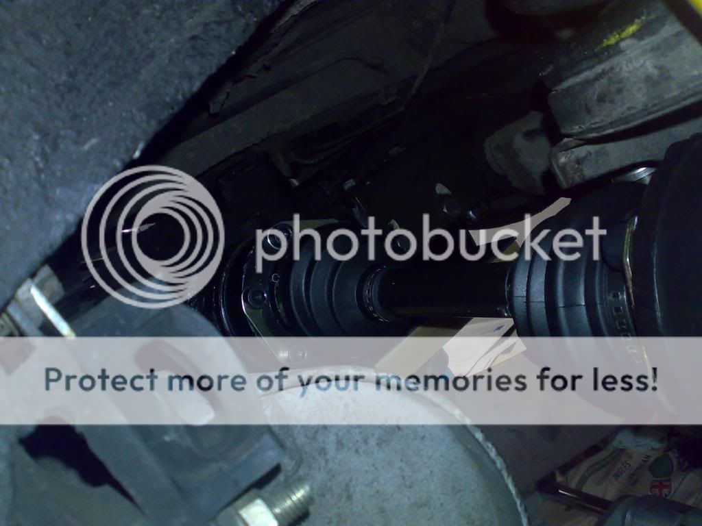

you need to apply a lot of torque in a not very comfortable position,...view of the two tools:
there is no need of dissasembling the rear exhaust

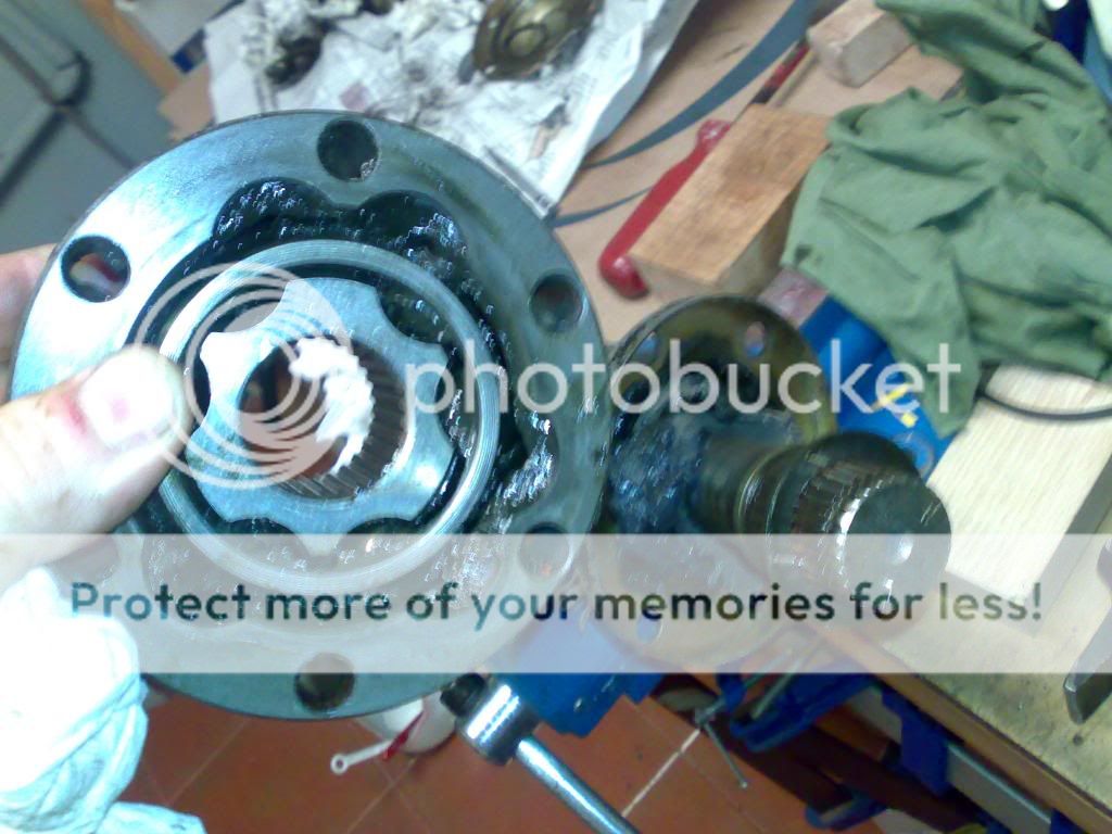

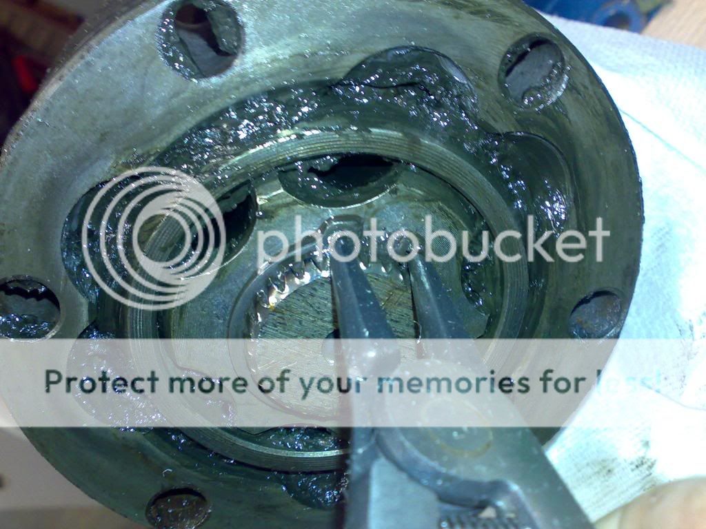

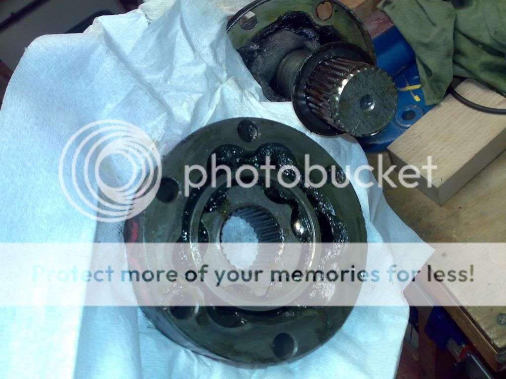

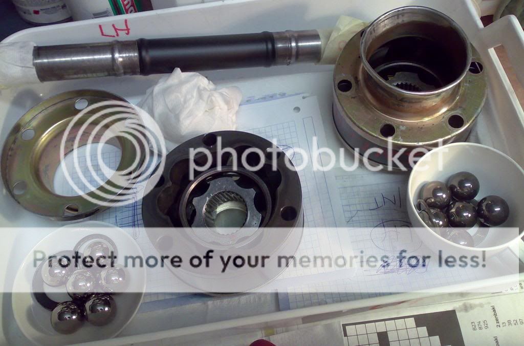

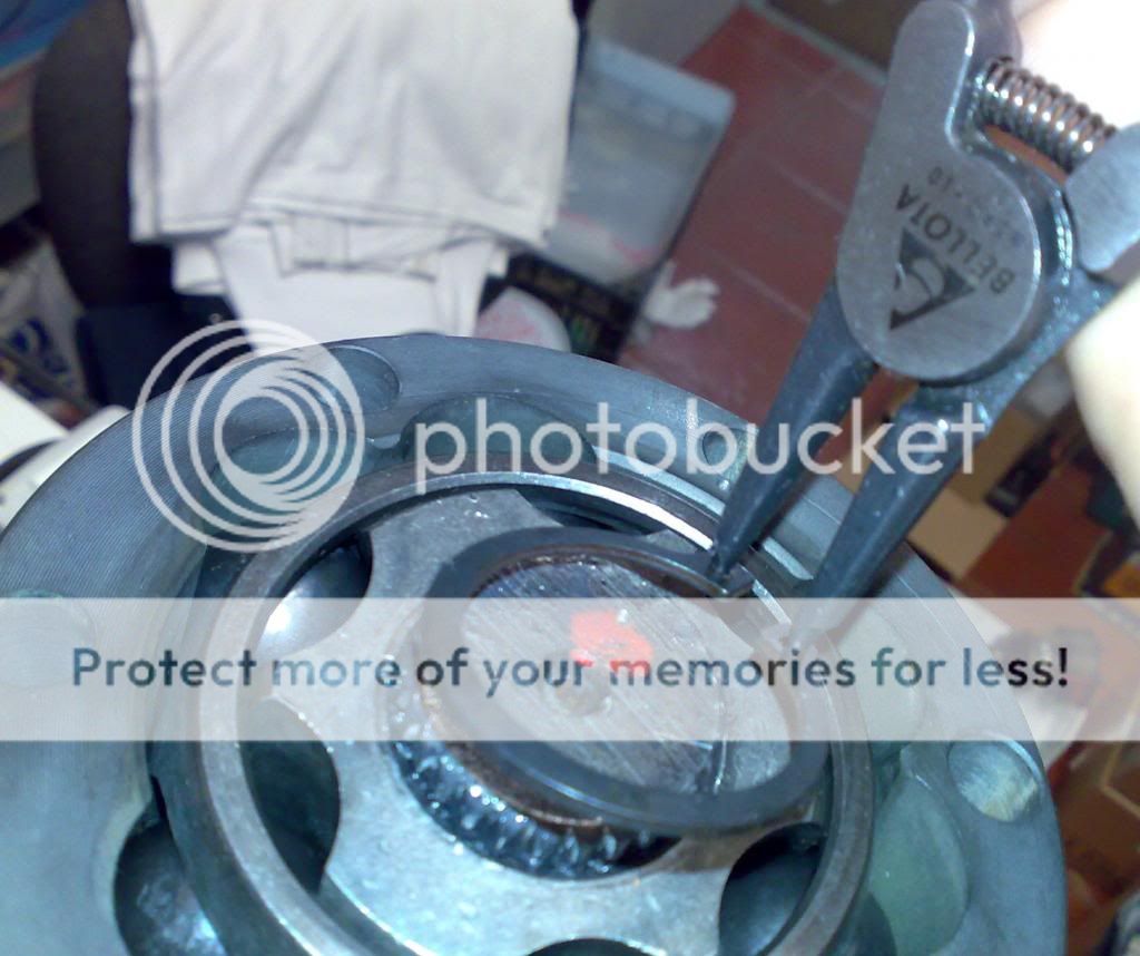

then you remove a retaining clip

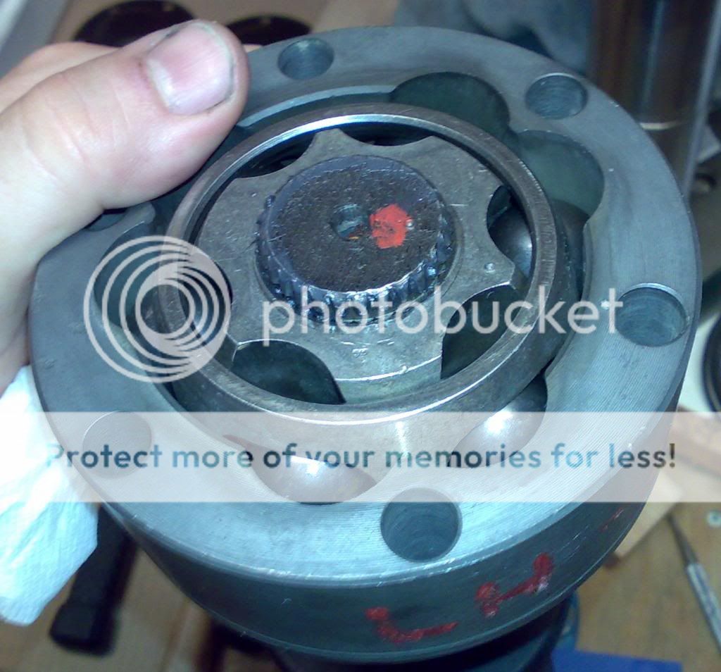

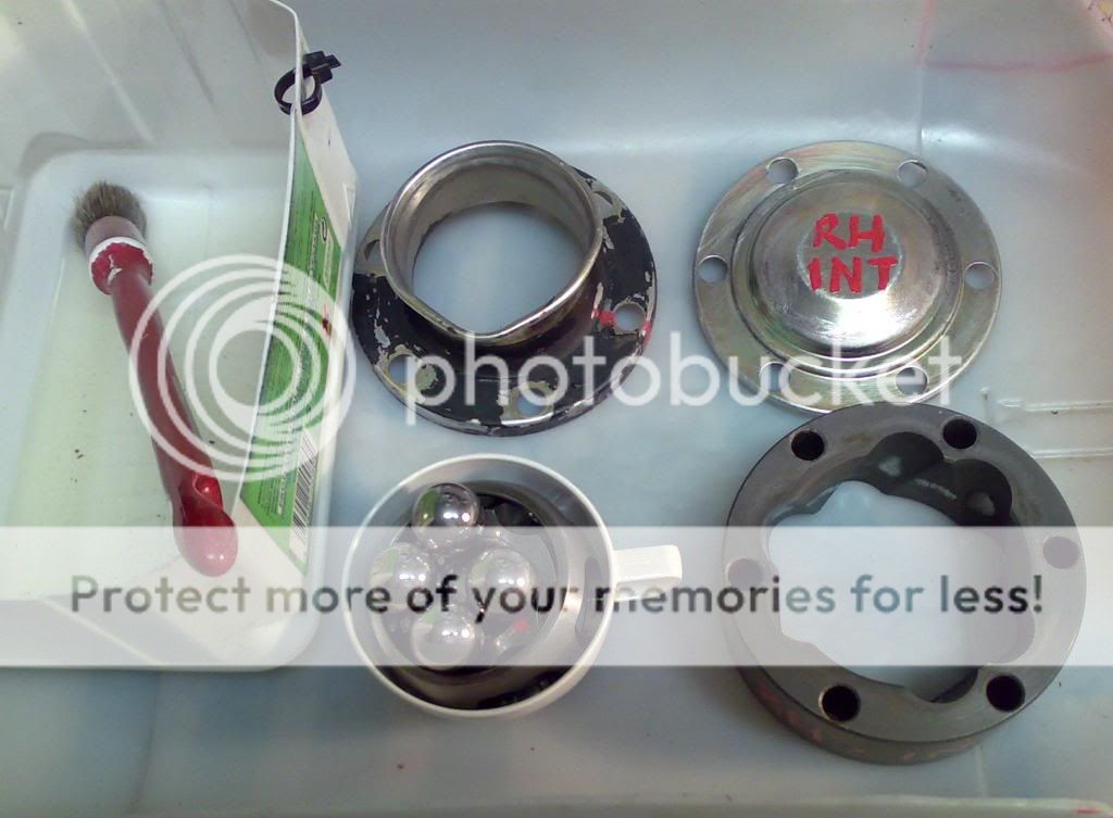

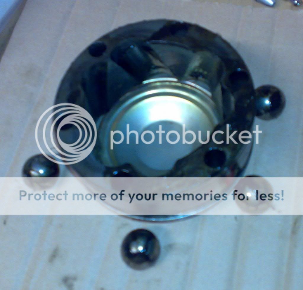

and you remove the parts one from the other by rotating and removing the balls one by one, i can not explain the process, but it flows as you rotate and tilt the housing
then, to extract the central support of the system i used this:

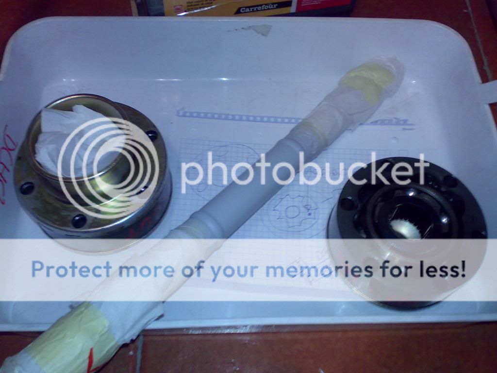

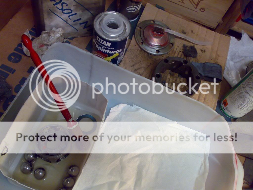

for me the most important thing is to mark as much as possible to reasemble in the same position and place:

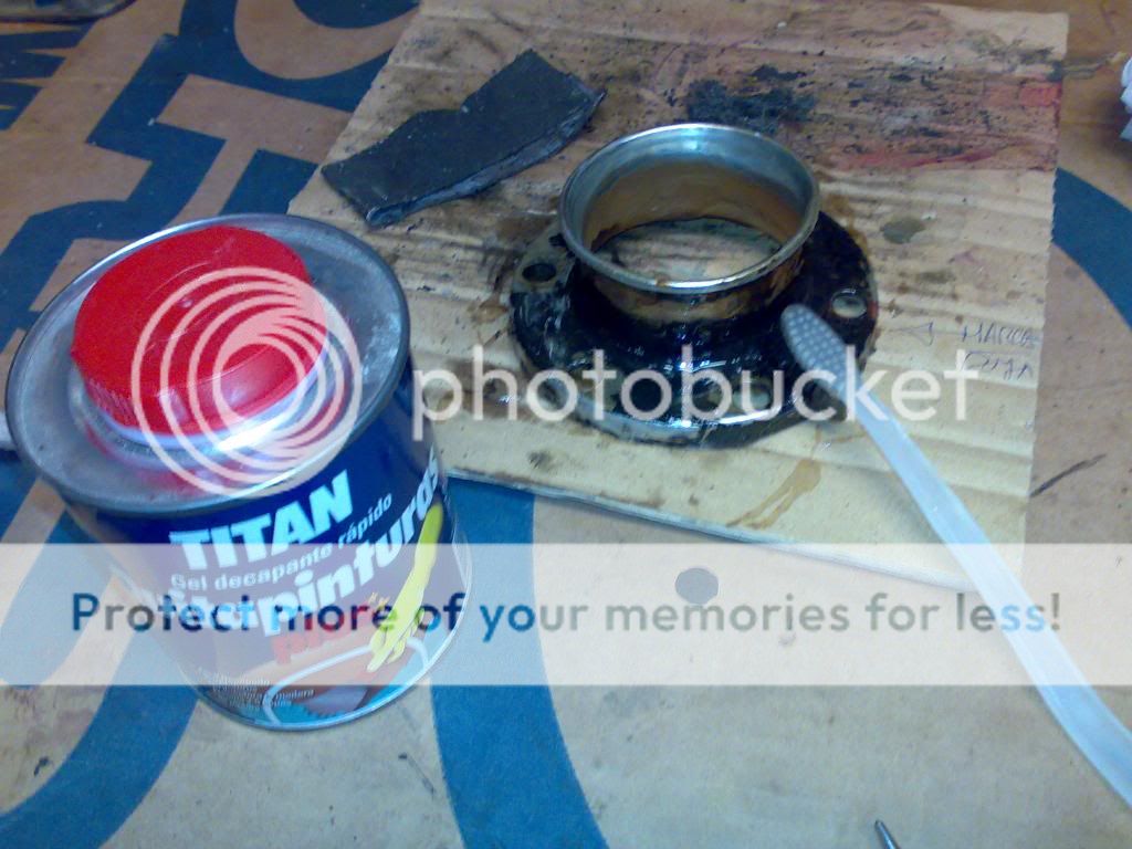

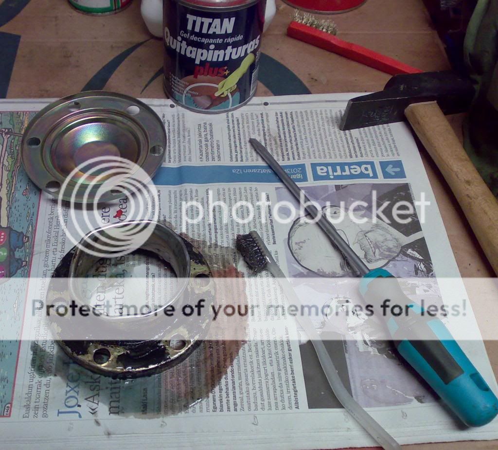

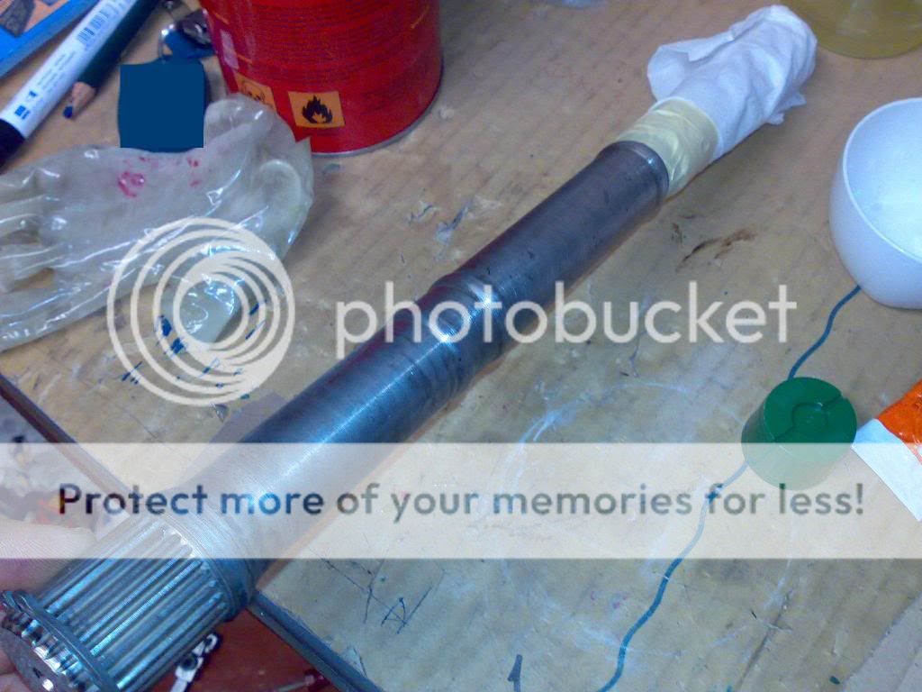

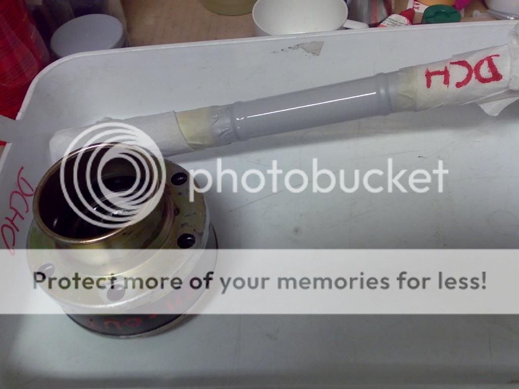

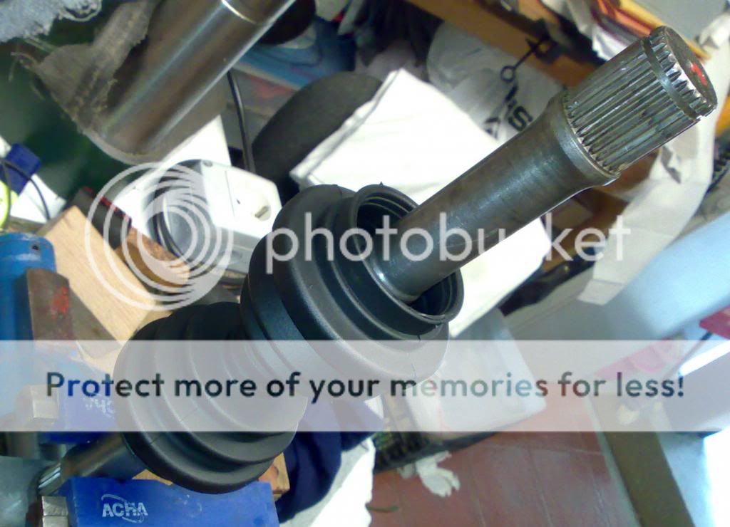

using paint remover:
axis clean and repaint:

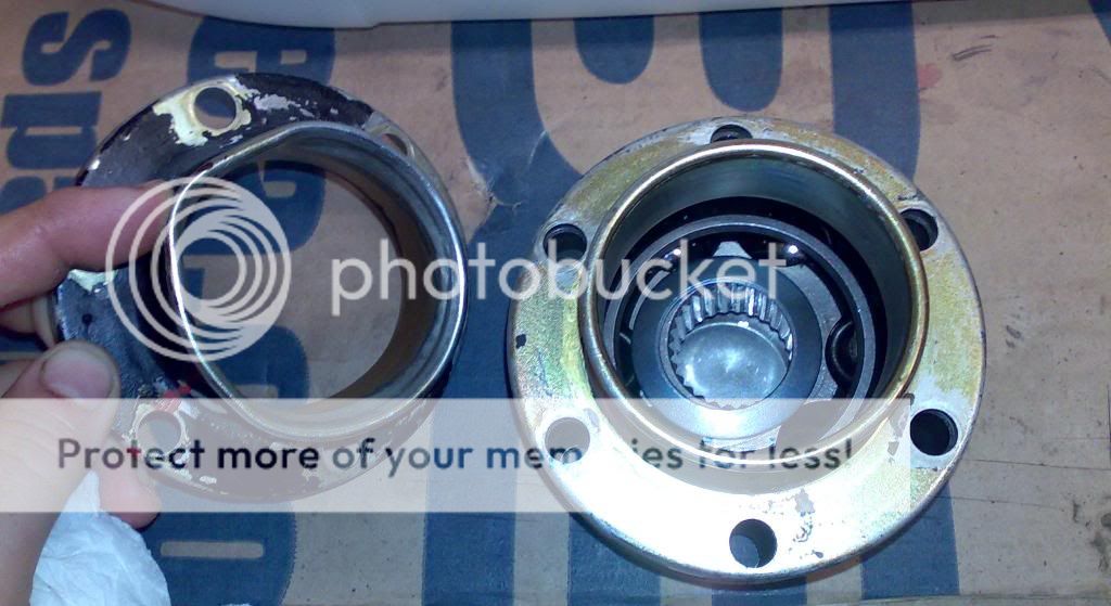

seet he damaged interior cover that was cause of the break of the rubber boot: compare the wrong (left one) with the good one (right side)
there is a solution comming in a parcel from germany,...

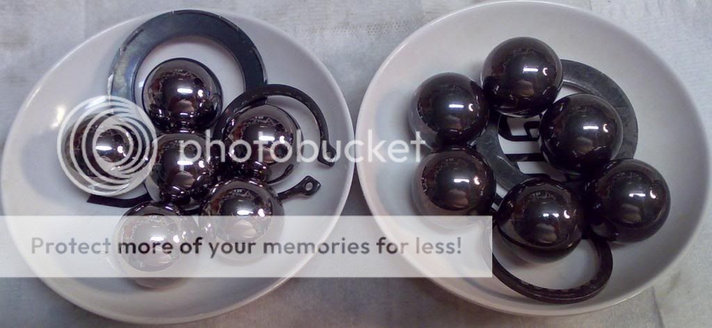

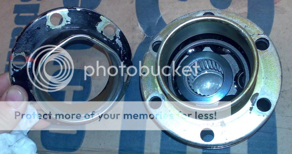

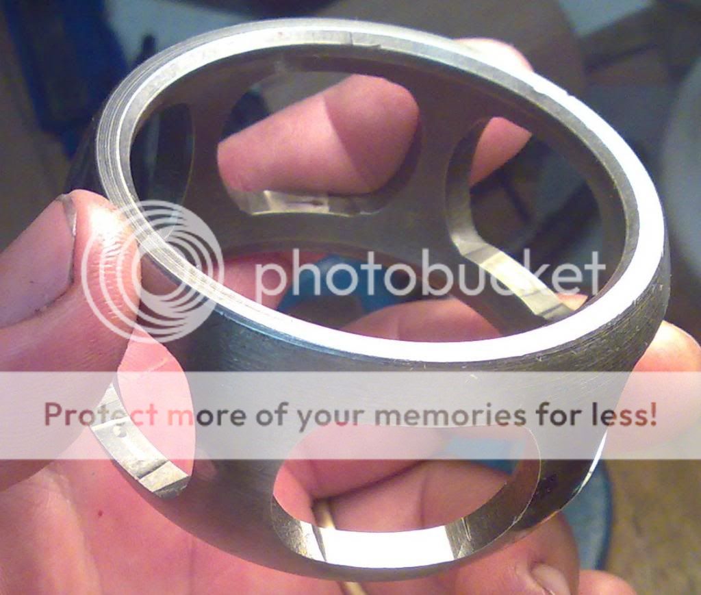

it has always been said that is better to find a car that has never been repaired,...well this was repaired, one of the sides of the CVjoints was repaired, a different boot was placed, and more important, different grease (more liquid) was found, and this is the result:
you can see that the balls of the renewed one are darker than the original:
than means, incorrect working performance, and less heat dissipation, so the balls were "burned", and that means, damaging the support:

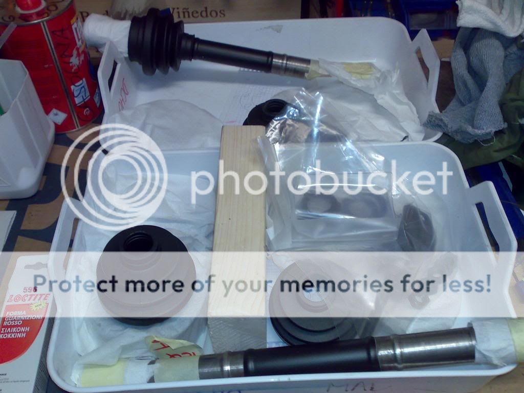

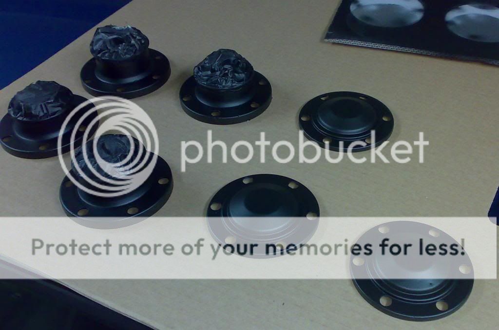

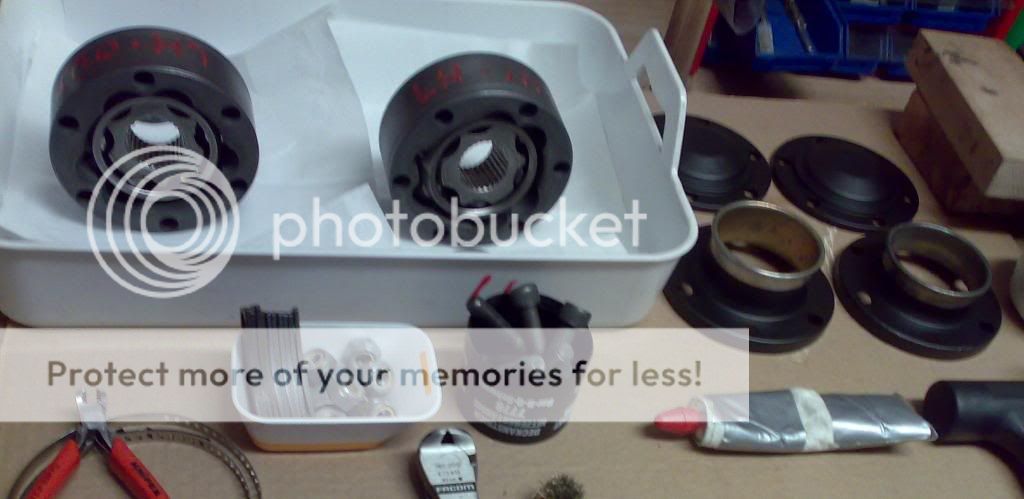

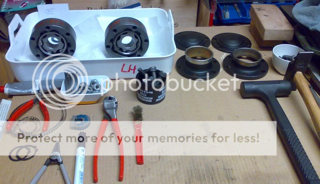

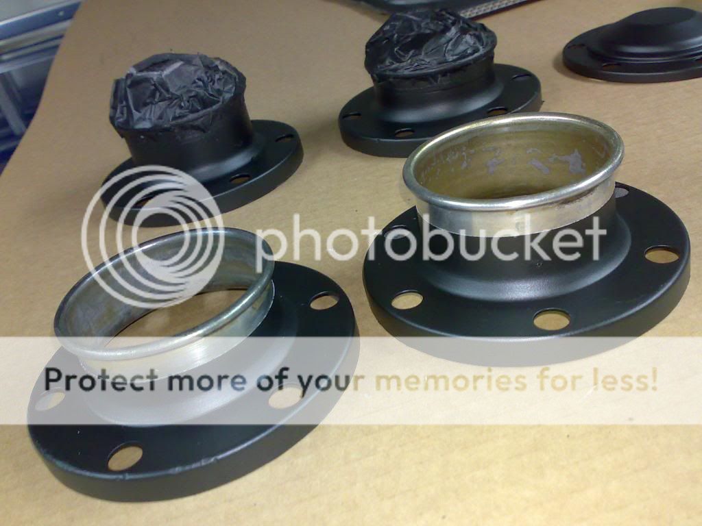

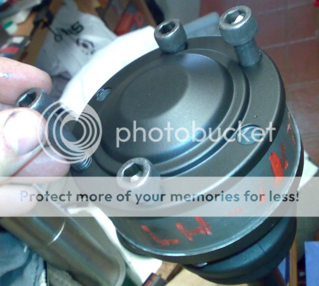

well, the covers next to the differential were very deteriorated, so my friend Patrick sent me an spare from his e3 (vielen danke)
you can not use the e3 CV on the e9, but i can use the covers, and the mechanisms

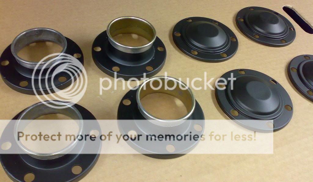

the inner covers of the e3 are a bit shorter than the e9 ones, but that makes no problem

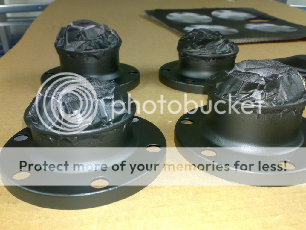

i painted the covers in black after a anti-rust primer:
here you can see the differences (the short one is from e3)

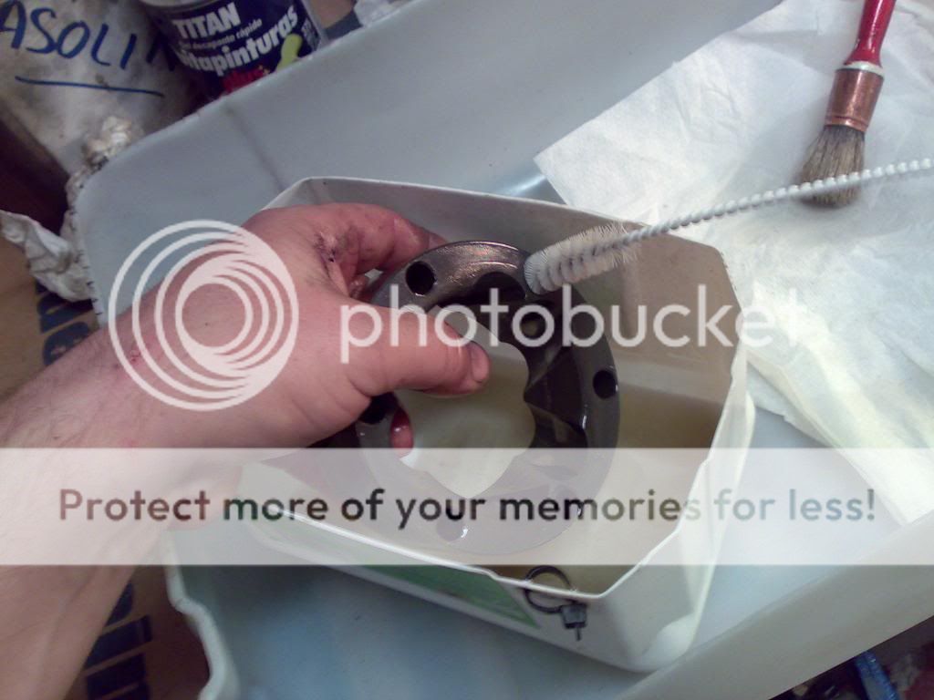

i cleaned the mechanisms carefully, first with petrol, and then with alcohol, and finally i blew air through them and let them dry

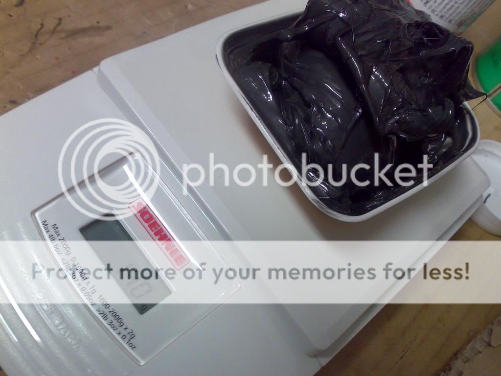

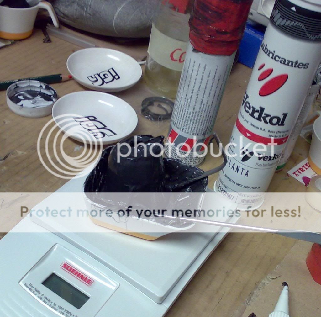

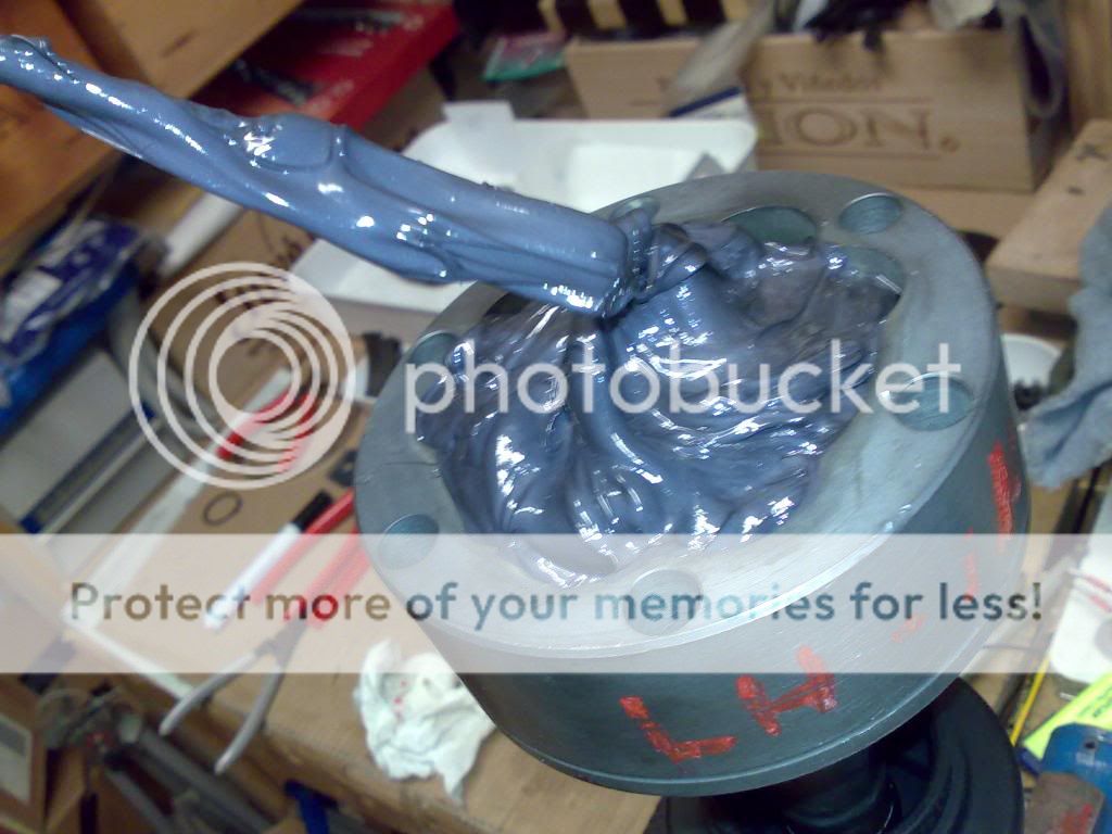

using semisynth moly grease, weight 120gramms for each side:
as part of the grease remains in the cup, i pour 140gramms
remember that i marked everything, so i repeat the exact positioning

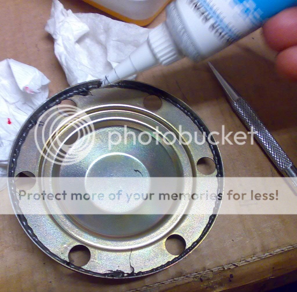

sealant:

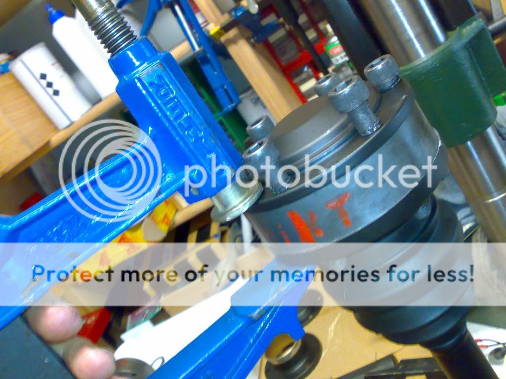

use the blots to center and align

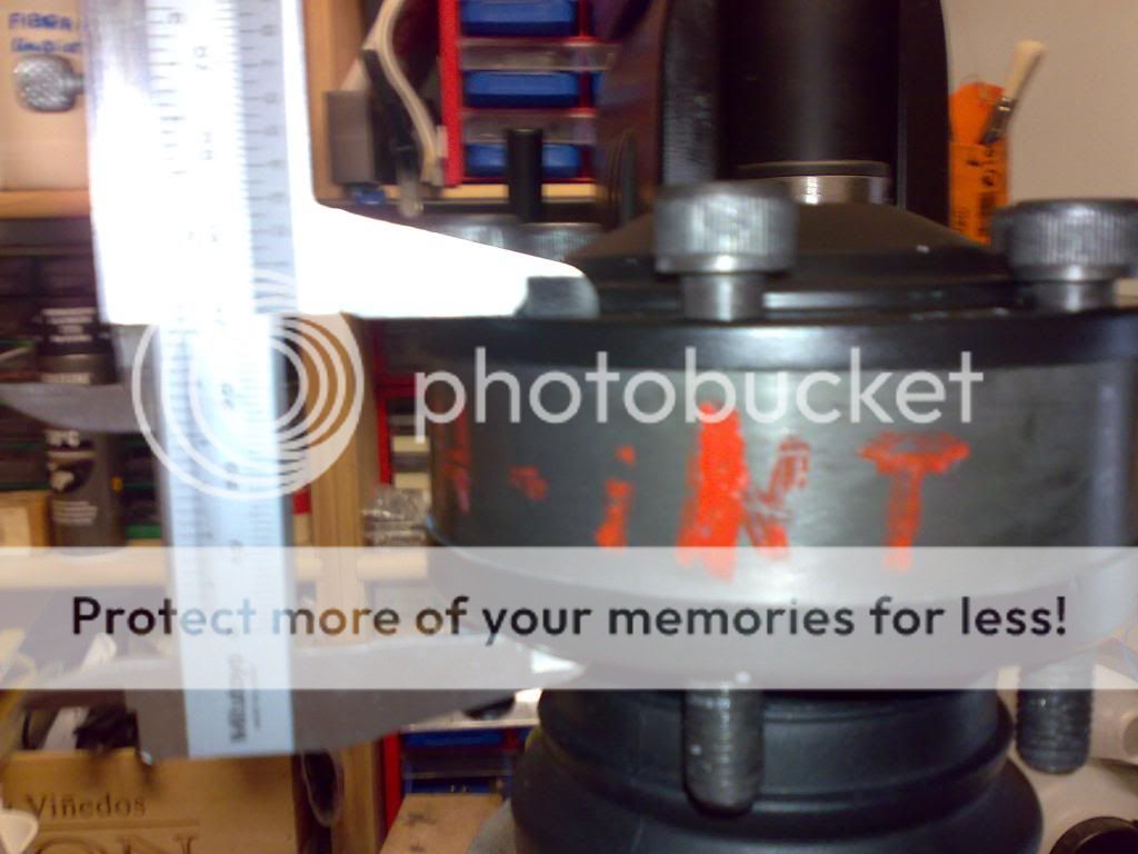

press diagonally into position,

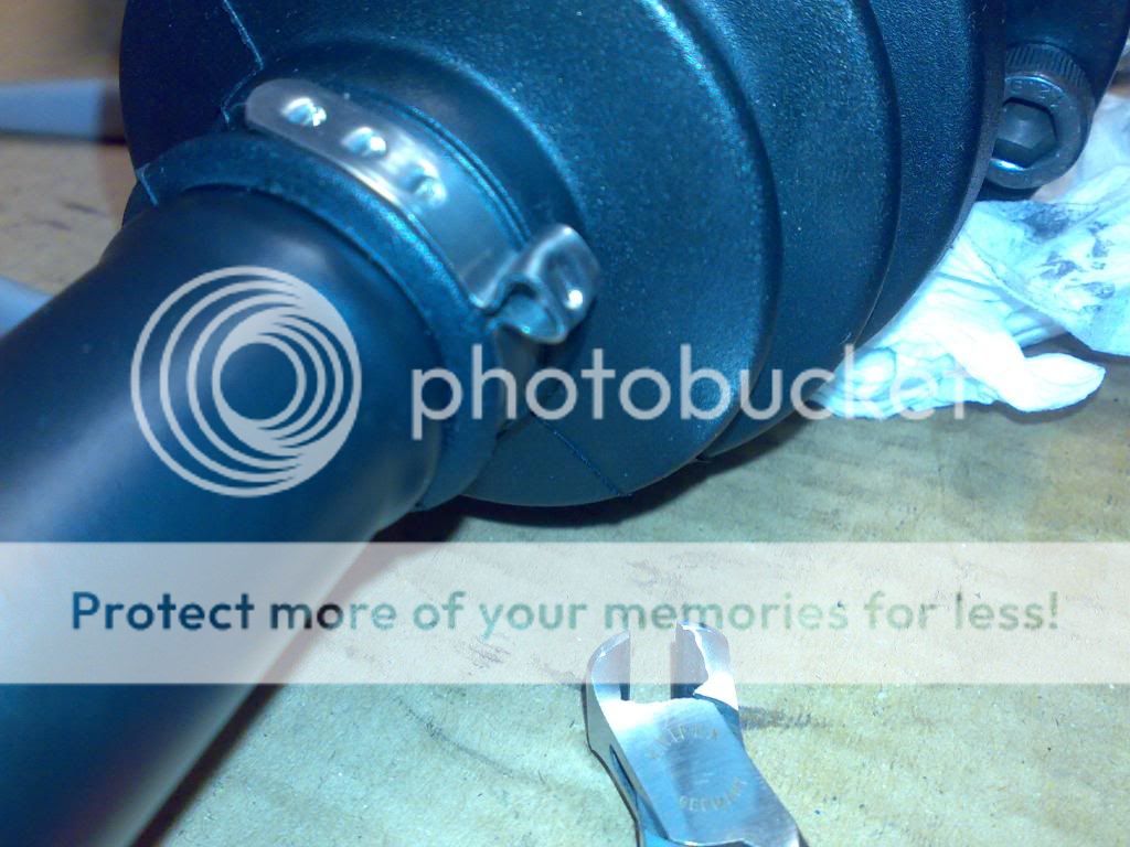

must be 42,5mm

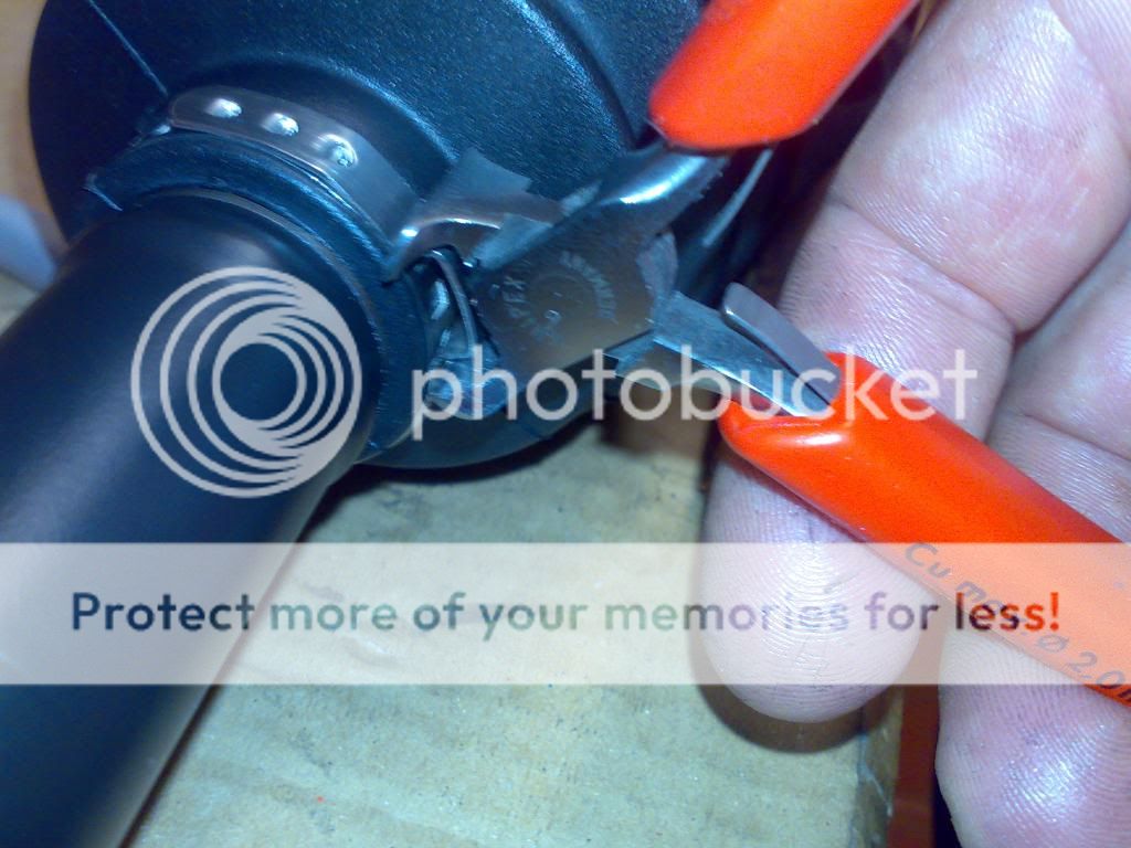

special clamps
and ready to go to the car:

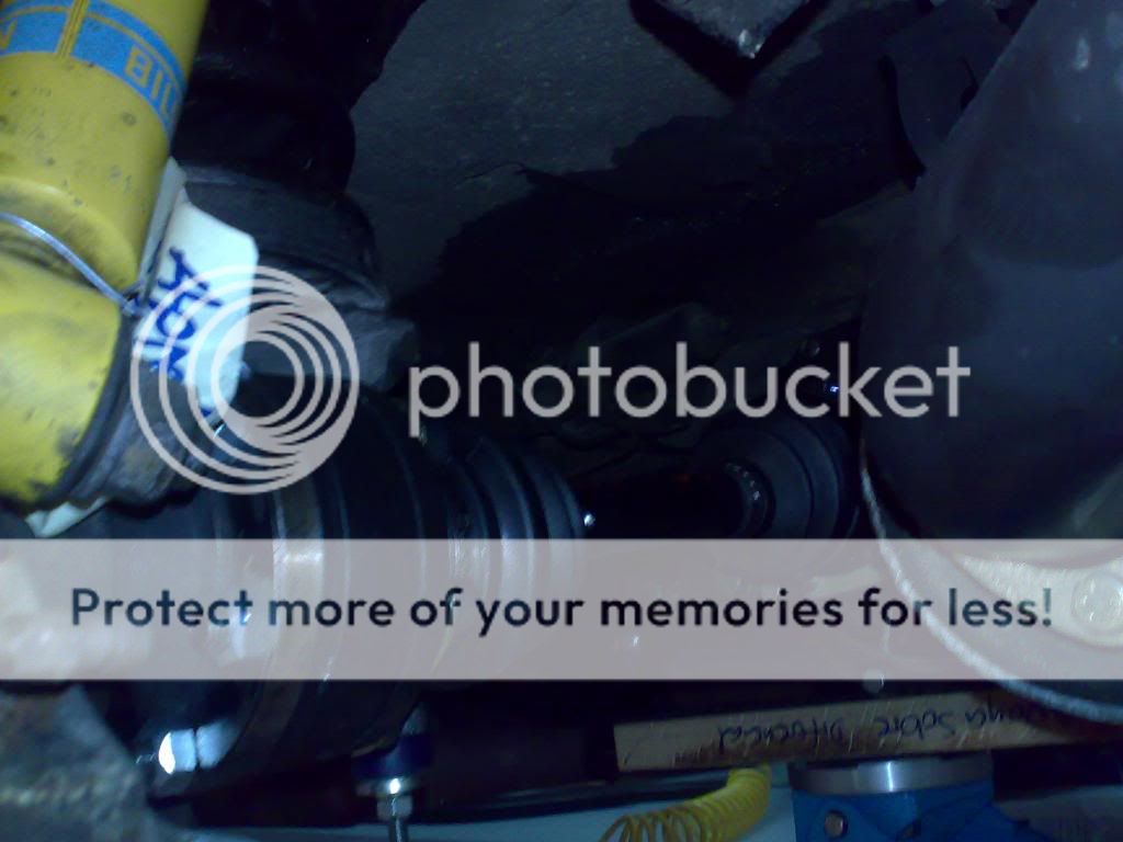

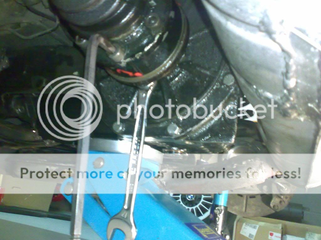

final assembly:

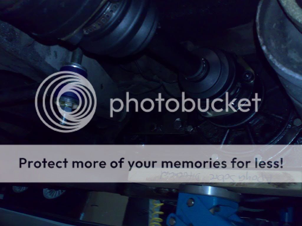

tips: use a jack under the diff, using a block of wood to spread the contact point, the jack in the diff is needed to assure an angle between the diff and the wheel sides, otherwise is impossible to introduce the CVjoints
as soon as you introduce them, place a bolt or two in each side, and then proceed little by little doing the bolts until contact of nuts to their sitting position but still a bit loose, do it sequentially to assure the centering of the parts
dont forget the bicromated plates that sit between two bolts
it seems to be impossible to give the right torque with an adequate tool, you can not introduce any tool there !, so the torque given was: "that-is-all-i-can-push-this-f-tool"! (in Newton x meters obviously), theoretically 85 N.m
another tip, i place the CVjoints, and start aproaching the CVjoints to their sitting plates little by little using the bolts and nuts sequentially and in diagonal, when there is an even contact of all the nuts to their bolts, i released the jack and in that position (real working situation with the weight of the car acting) i finished doing the bolts

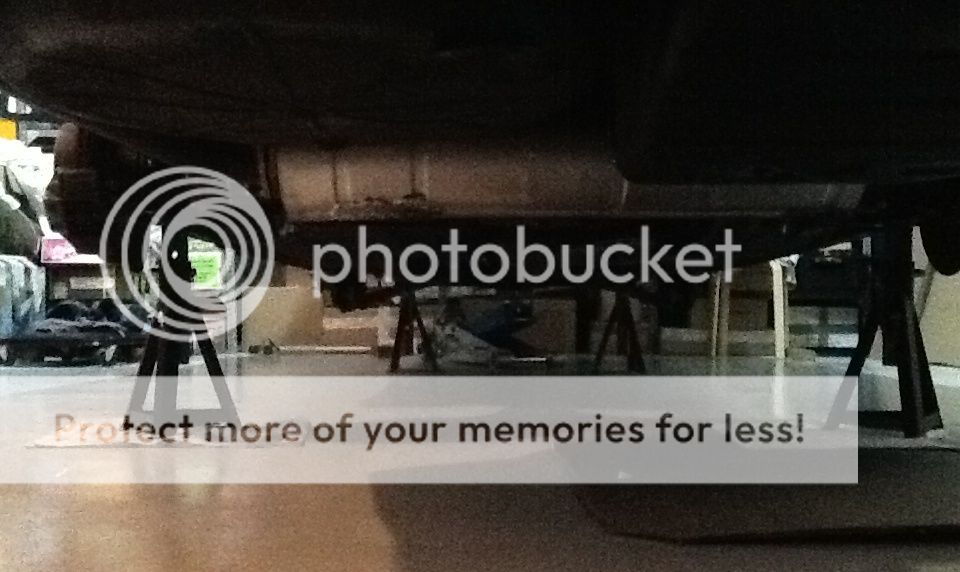

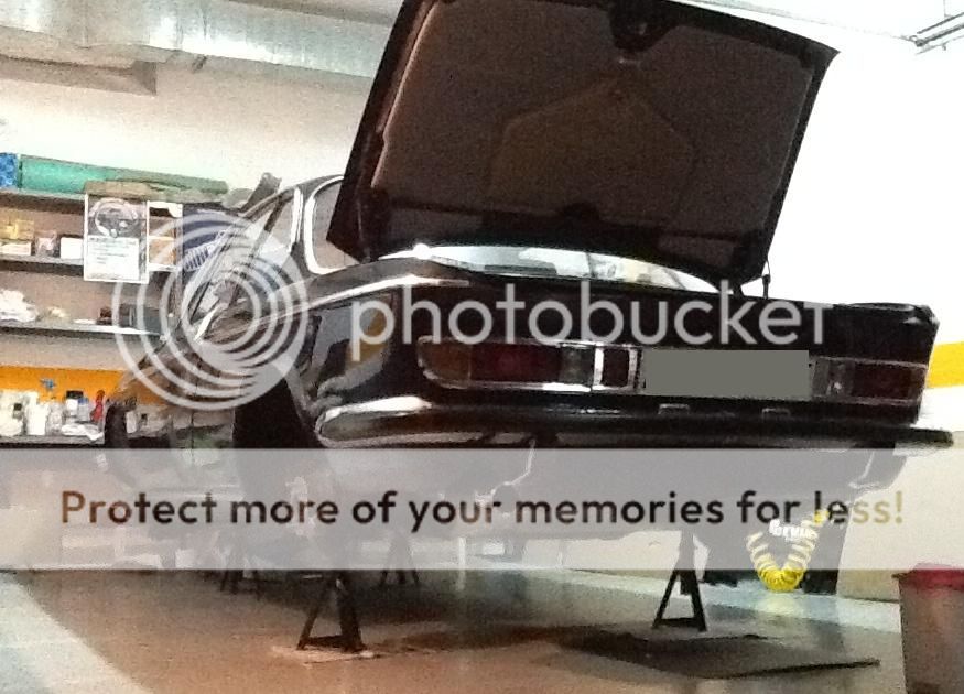

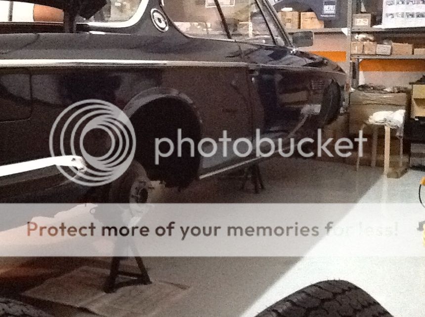

bueno hemos andado con el purgado de frenos y tal , asi que he tenido que poner el coche a cuatro borriquetas, como es la primera vez y ademas he seguido un proceso revisado y razonado lo voy a contar por si es de ayuda
bien, pues el debate sobre la zona trasera que se inicio en un post de koldo se resuelve diciendo que al menos para el e9, es correcto levantar del diferencial, el propio manual original lo contempla, eso si. poniendo una tabla gorda entre el dif y el gato para repartir el esfuerzo, por lo que koldo hizo perfectamente
en la zona delantera, tras revisar aqui y alli tambien he encontrado un punto central, y es bajo el subchasis delantero, siempre que el modelo disponga de una placa corrugada, (en mas antiguos modelos o versiones, esta chapa era lisa, por lo que no se puede hacer esto), asi se puede levantar de ese punto
el disponer de un punto central para levantar proporciona comodidad y tambien seguridad, a nadie se le escapa que una vez sobre dos borriquetas, el plano se define con tres puntos y no con un proceso secuencial

Con un local asi, me dan ganas de entrar en tu casa y okuparla.
Pregunta uno.
Desconociendo la situación (si se encuentra) en el E28 de un punto que evidentemente no sea el carter para poder subirlo en borriquetas ¿ lo aconsejable seria buscar los apoyos donde se situa el gato para el cambio de rueda?.
Pregunta dos.
Aunque joda, ¿es acaso un podrido en el silencioso trasero lo que ven mis ojos?.. ¿un podrido en ese vehiculo impoluto?.
Pregunta tres.
¿Las hojas de periodico son para conferir algo de altura extra en las borriquetas?.
Pregunta cuatro.
Asi a pelo ,sin neumatico tumbado entre el vehiculo y el suelo, sinceramente ¿ se trabaja a gusto?.
dequincey
be em be e neun
5 Nov 2009
11.063
9.851
huy, huy, huy,....kontigo santiago siempre es dia de fiesta !
para poder okupar vas a tener que desokupar primero, y me temo que como decia john wayne en rio salvaje mientras vaciaba su winchester 75: "dios mio, son demasiados !"
los apoyos del cambio de rueda, buen apunte, pero es que tienen el inconveniente de ser dos, asi que si por ejemplo no tienes dos gatos, pues eso que te jode, primero uno y luego otro, ademas con el desbalance que supone subir, colocar borriqueta y bajar, y otra vez a empezar.
por cierto, no siendo apoyo del carter ojo, sino estructura de subchasis del eje delantero, me temo que el e28 tambien la tiene, leñe ! si es corrugada te vale...
el podrido del silencioso trasero no es tal ya, que lo fue, pero se reparo, ahora es una soldadura un poco apachusca que hubo que extender mas de lo inicialmente previsto porque no mordia carne y se agujereaba por lo mas barrido,
este vehiculo viejuno, que no impoluto, esta a la espera de que con un mes mas sin comer caliente de su sufrido dueño, pueda ahorrarle para un silencioso trasero como la santa madre iglesia nos enseña, dios, ....pero que caro es mantener el hierro esteeeeeeee
el periodico (literal, made in bcn), conferir, confiere, mas que altura (que tambien), suspension, donde este un apoyo mullidito de la borriqueta, y tambien aislamiento termico del frio suelo, anda que tu tambien le sacas punta a un clavo....pongo mogollon de periodicos para no tener que limpiar luego
pues lo de tumbar los neumaticos me parece poco masculino, si hay que morir aplastado pues se fallece ahi, pero sin ambages ni mariconadas, es como lo del cinturon de seguridad, quiza hayas leido una entrevista al forense señor fontela (se hizo famoso en su dia por andar enredado en casos muy tristes...), pues bien este señor dice que habiendo visto (por su oficio), los daños que causan los cinturones de seguridad el se niega a ponerselo, y paga las multas que le van cayendo sin poner una mala cara ni soltar una palabra fea
pues bien, tengo la suerte de que aun no hay una policia de revision de bricos domesticos, por lo que seguire sin poner neumaticos
(para consuelo tuyo, y de otras plañideras que hipoteticamente me afeasen la conducta, dire que cuando me pongo ahi abajo meto el gato y unos bloques de madera, dos, que da gloria verlos, porque yo en realidad soy señorita)8-[
