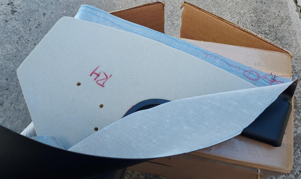

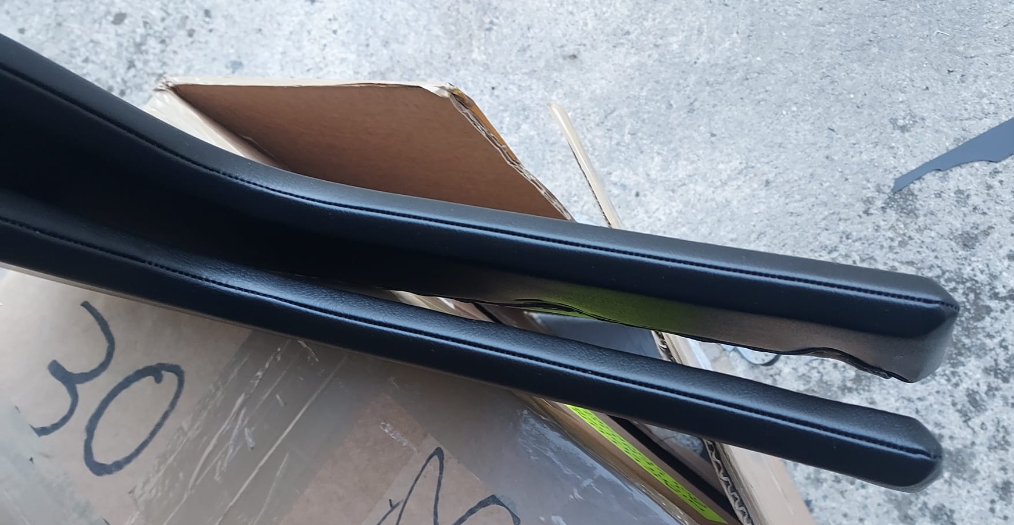

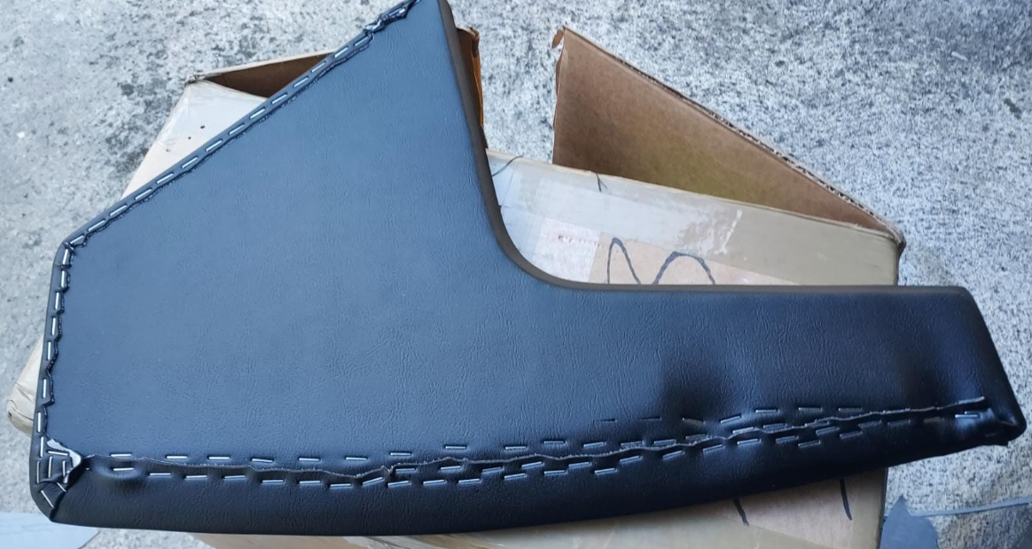

who needs metaverse ? Cuando puedes coser…
1661623180222-png.147209
the rebel paper template...and the solid keepers
1661623204499-png.147210
1661623249818-png.147211
ready
1661623286443-png.147212
fantastic
1661623323243-png.147213
some tips,
before starting use only one side marked and place the other side with plenty of excess, you will cut it afterwards
sew 4mm inside the border or give 4 mm excess, when you turn it inside out you will have that small corner to introduce it in the rubber channel of the lateral console
before starting sewing just sew 1cm long in both extremes to somehow fix the 2 pieces so that they do not move in excess
enjoy

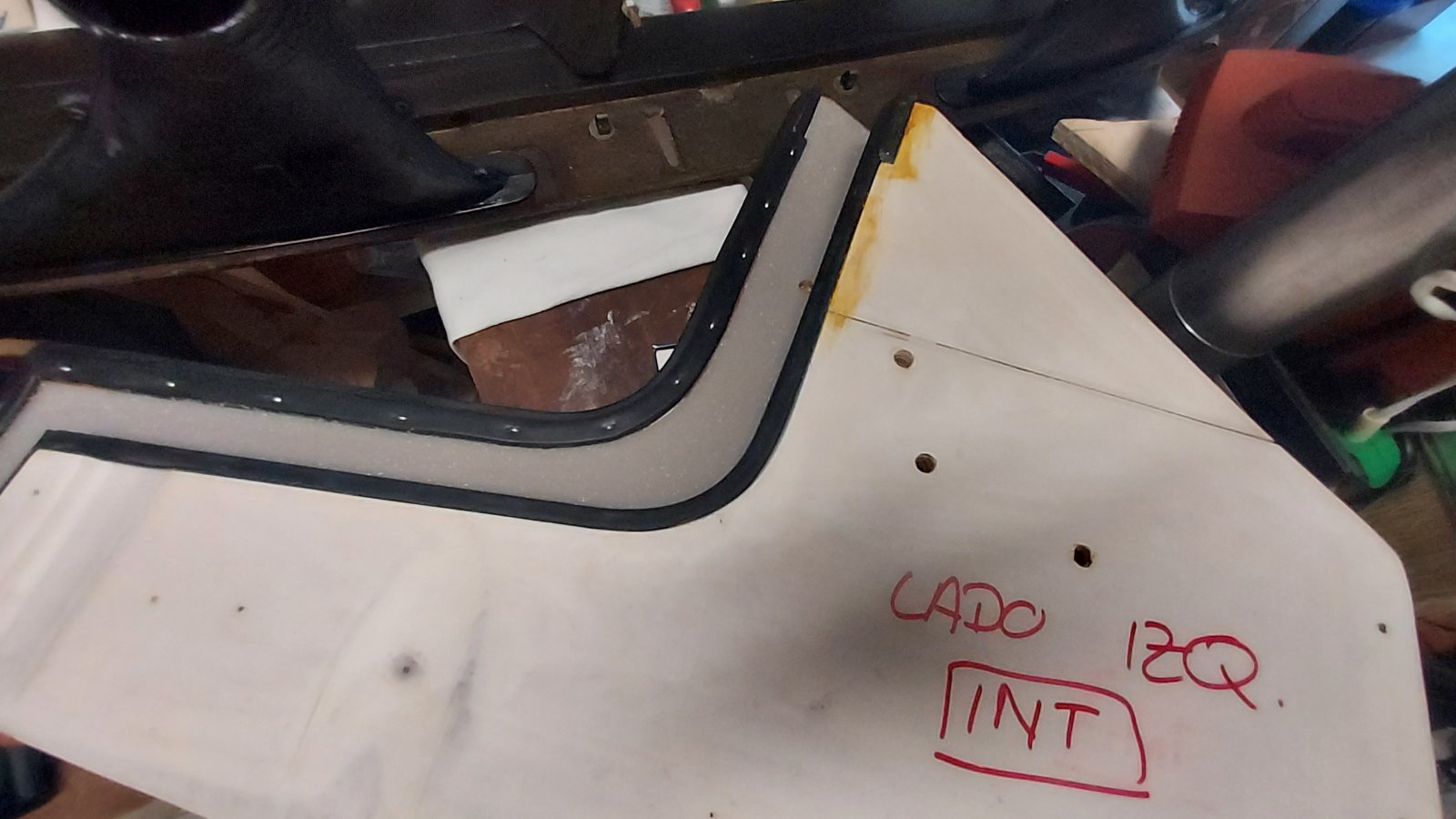

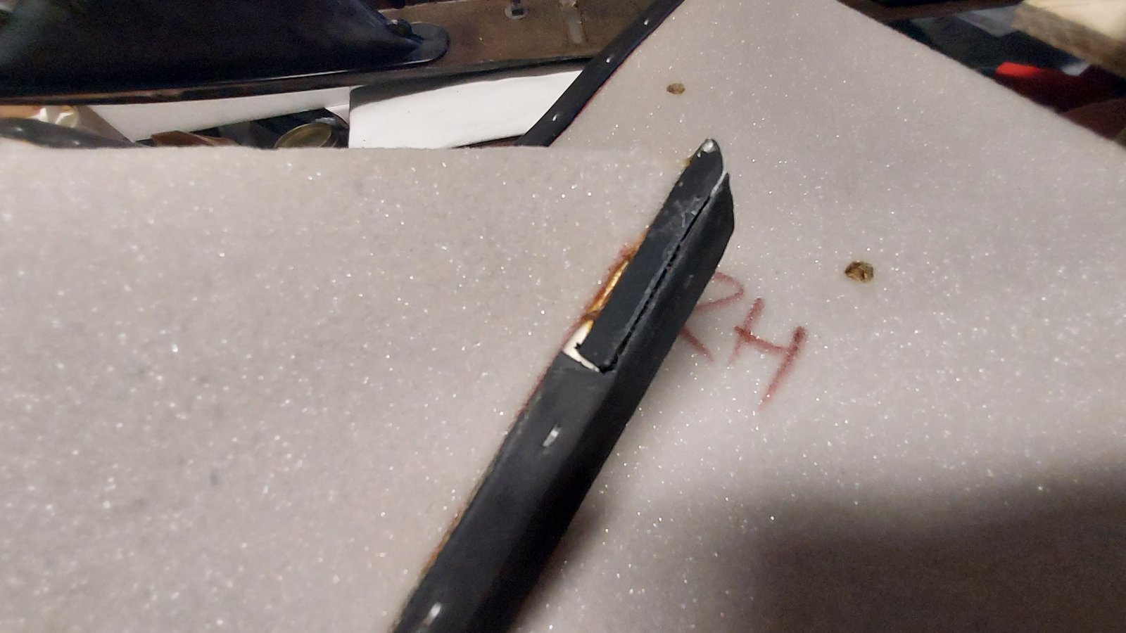

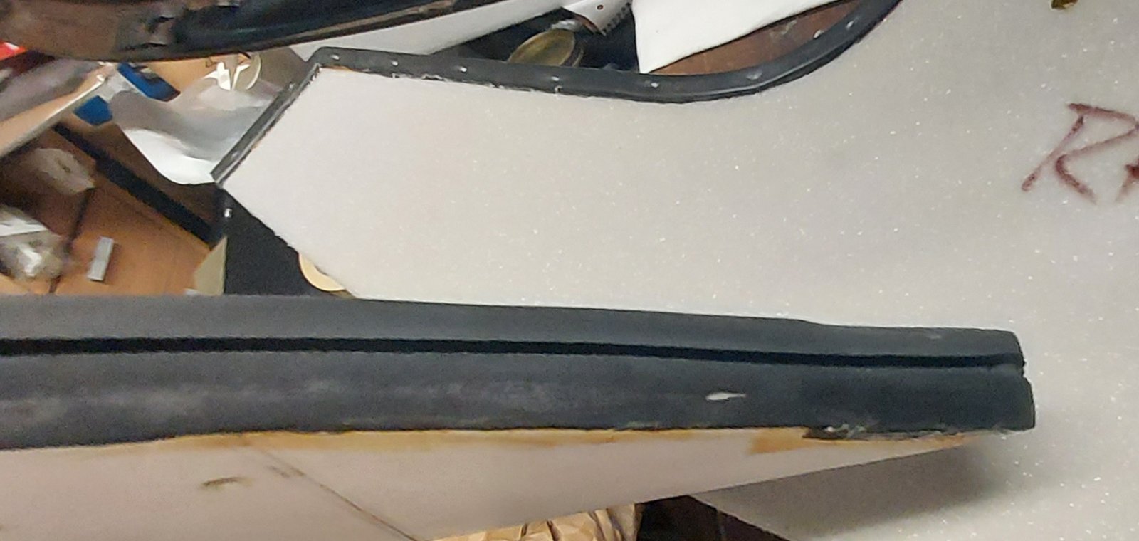

paneles de consolas laterales:
as to the wood that was finished months ago it still needed the rubber and the foam, so...
796556b9-e694-4f4b-a31e-f2da05f75152-jpeg.148809
6d5270b7-27ed-406a-ab13-8aea9e70ae0a-jpeg.148810
366edec0-ba65-4aad-975f-cec704c04a79-jpeg.148811
adb27fa5-0ac0-49e6-8a40-4af0d78b31b9-jpeg.148812
547e9b8d-f876-4dbf-8d0c-2b280adc5193-jpeg.148813

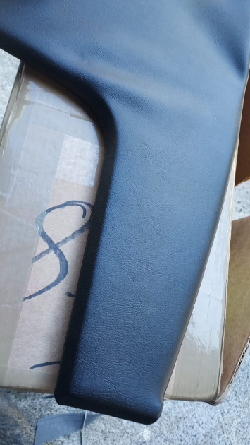

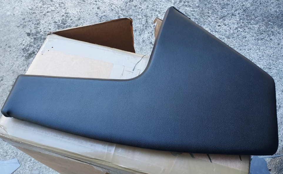

so, once all this was ready it only took 2 hours to complete the upholstery process,...i am getting old...
1664778484259-png.149295
1664778510787-png.149296
most difficult part is to get the edges inside the rubber channel...
1664778811173-png.149297

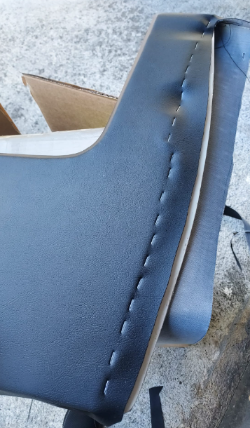

start in one corner back side
1664778848043-png.149298
1664778876504-png.149299
then turn other side and pull while puting staples to fix
1664778942096-png.149300
keep the tension and work the other end
1664778965264-png.149301
1664779018990-png.149302
1664779045472-png.149303

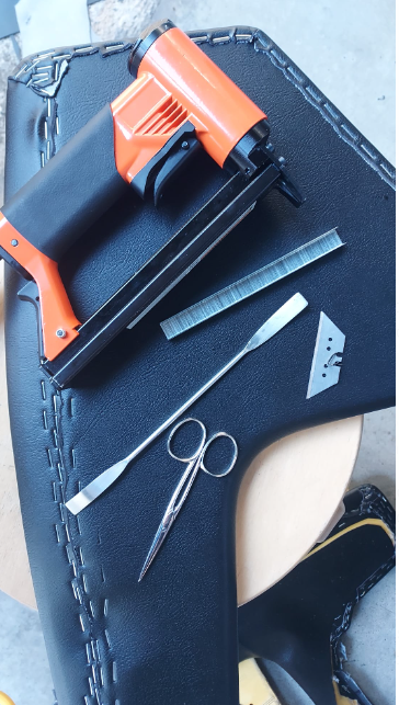

tools
relevant:
1664779088126-png.149304
1664779120638-png.149305
1664779154221-png.149306
ready for the alu trim lines
